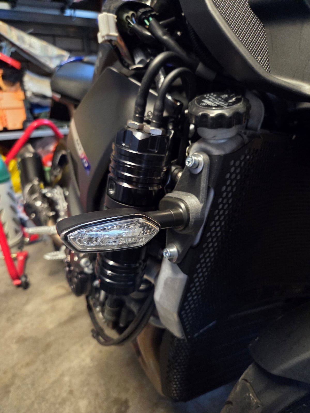

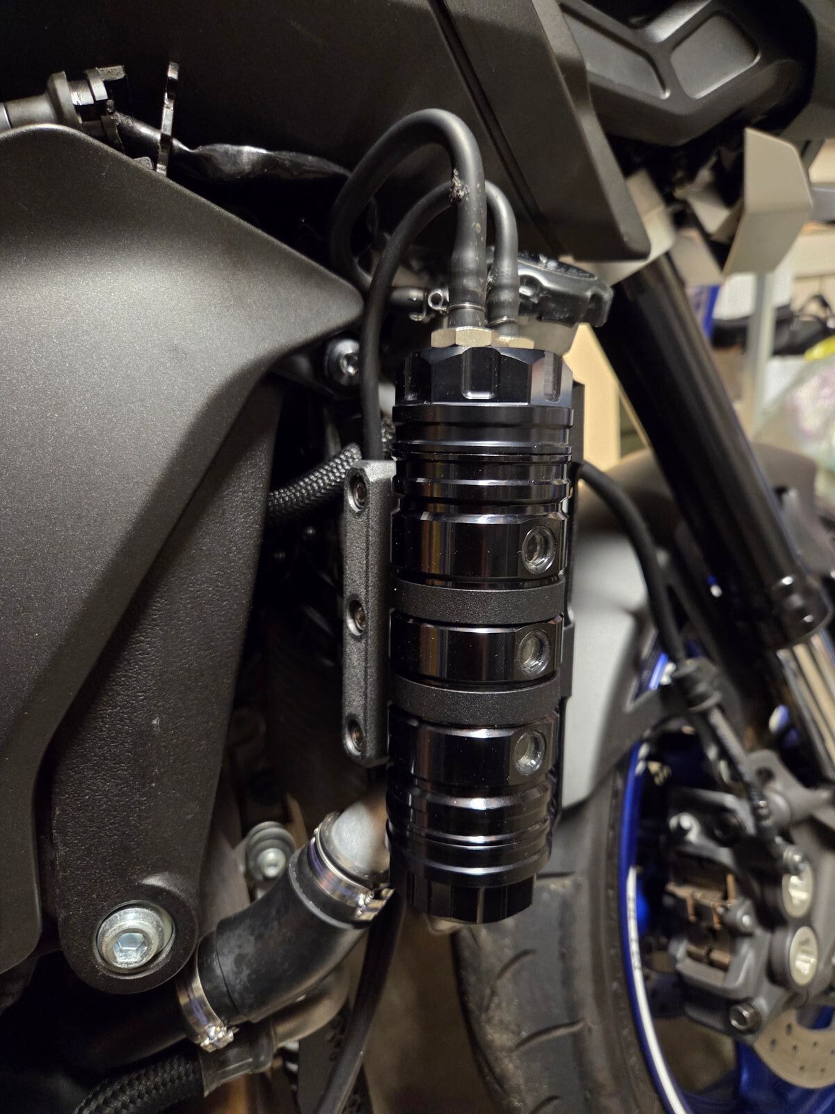

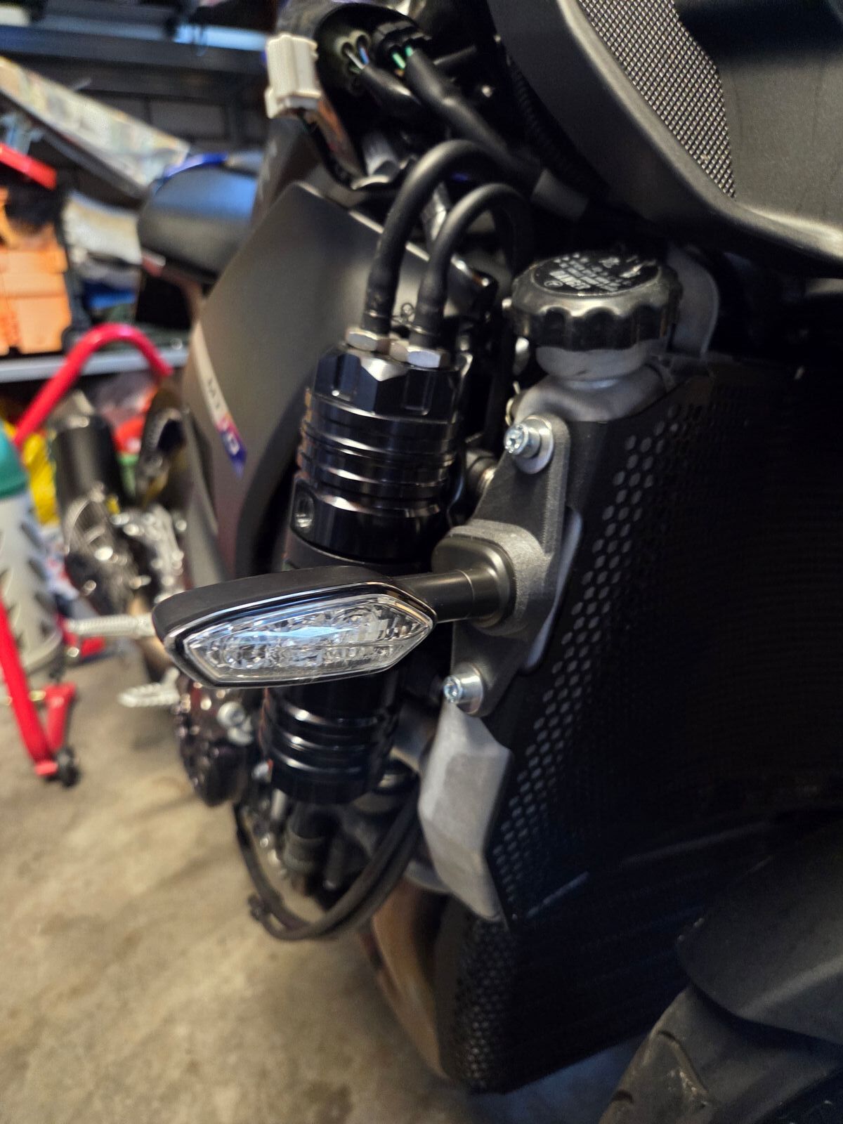

  • #56
    Hi all, I wanted to update you on the coolant reservoir mod.
    I modeled and 3D printed a bracket for the custom "MGM" coolant tank. It looks really slick in my opinion. Thanks for your help!
